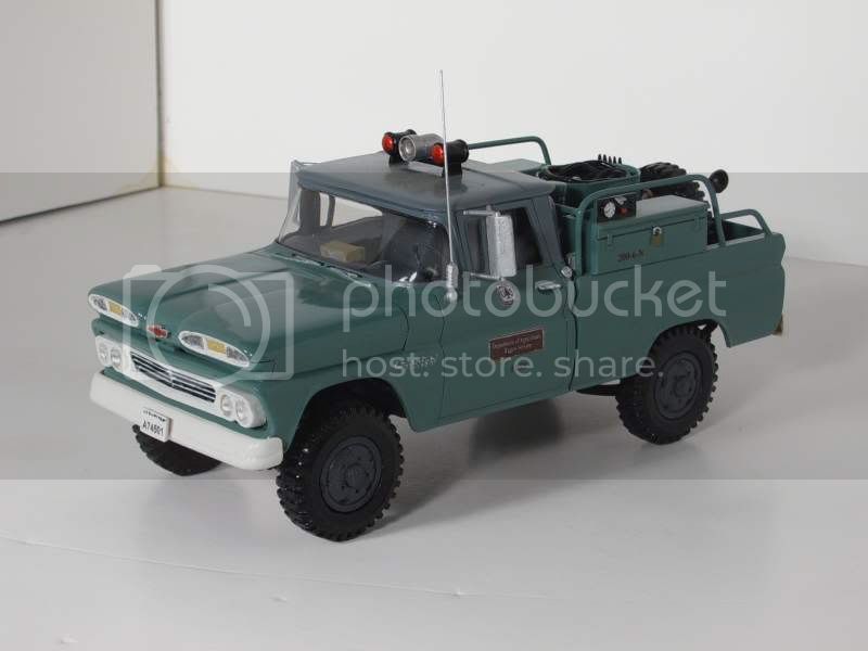

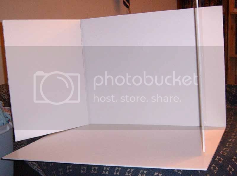

I use 3 things, a photo box I made, a tripod and halogen work lights.
I built this box from 2 pieces of foam core, it folds up flat for storage.
For lighting I have a tripod mounted twin 500w (1000w total) halogen work light. It telescopes up and down so I can adjust the angle of the light and the 2 light heads independantly turn as well. I also have a pair of clip on 150w halogen lights I started with and occasionally use for additional light but I rarely need them.
The tripod is a chep thing I picked up at Walmart for $20, works great. I do not use the camera flash but I do use the timer which helps avoid jiggling the camera. I use a 4mp pocket style digital camera with a 3x optical zoom, so nothing particularly fancy about the camera although it does have a close up setting, but not a real Macro setting, I use the zoom to bring the model closer.
