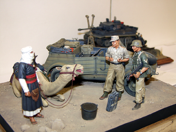

The Raw Image - 600 x 400 pixels - 296 kb
This images had ZERO additional compression. I took my original RAW image and
re-sized it for this example down to 600 x 450. Then I used the standard
"save-as" function in Photoshop and select JPG and maximum as the
compression level. This created the image as a 296 kb (kilo-byte) image. This
image would be fine to submit as is (unless you had many images like this and
cumulatively they caused a problem to send).

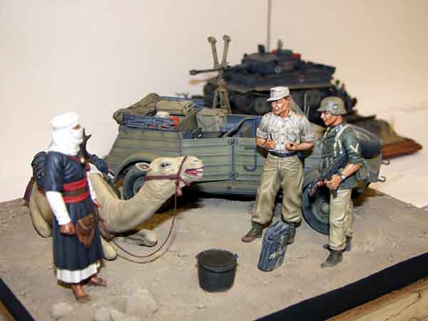

Maximum Setting - 600 x 400 pixels - 104 kb
This image was made using the above image and the "Save for Web"
feature in Photoshop. This is a special function in Photoshop that makes a
"web-ready" image that is as small as possible. This image was saved
again using the maximum setting (meaning maximum image quality or almost zero
compression). You will probably note right away that there is NO VISIBLE
DIFFERENCE between this image and the one above even though this one is
almost 1/3 the file size. This image would be perfect for
submission as is.
