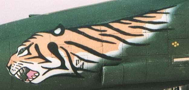

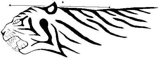

I used my HP 4P laser printer for several years before I ever even heard of the ALPS printer. I created lots of really great looking markings using my laser printer. One example is the NJ ANG Tiger F-4E Phantom.
To the right is the full image I printed on my laser printer. To create the full color tiger heads, I carefully masked the full color portions of the tiger heads on the nose of the F-4 model using frisket paper. I traced the shapes I needed to cut in the frisket directly off the tiger decal I had printed. The dots and line in the image, just above the tiger head, were used to align the masks on the model. These alignment marks coincide with panel lines on the model. After the painting was completed, I applied the black-only outline decal over the color areas to define the finished marking. The results speak for themselves.

usefulness of the full color markings. I used my HP 4P laser printer for several years before I ever even heard of the ALPS printer. I created lots of really great looking markings using my laser printer. One example is the NJ ANG Tiger F-4E Phantom.
This decal design on the computer with a masked and painted background on the
model ...
created this marking on the model.
