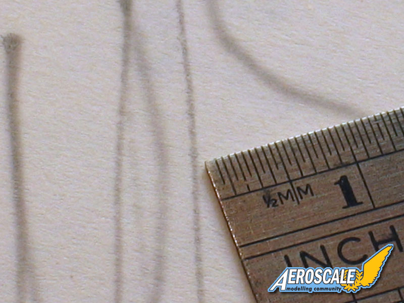

In action, the results were very impressive. I used the G35 straight away with some LifeColor acrylic and, without making any checks or adjustments, found I could achieve lines of 1mm with no problem at all at the first attempt, without resorting to the close-up tip. Control of both the air- and paint-flow was smooth and instinctive, and spray patterns were nice and tight, with no spattering or over-spray. The airbrush is comfortable in the hand, with a well placed trigger and the overall balance is good.
