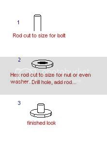

I am trying out for the first time to make some minor changes to DML's Loki. And the first block I came across was trying to make decent bolts and nuts. I bought some stripstyrene and attempted to cut them, but all were out of shape.
1. Did you guys uses stencils to mark out the outline?
2. Can anyone assist and point me to some reference on how to do it?
3. How to do rivets?
Appreciate all the help I can get.
Thanks!

I use many methods of replicating nuts & bolts. What you can use for rivets, superglue or Elmer’s (school) white glue. Draw out your rivet line and add drops of glue onto the line. Works pretty well, you’ll have to practice a bit to understand how much glue is needed.
Nuts & Bolts, I like to cut mine from Evergreen Plastic rods. They come in many shapes and in hex shapes and sizes. Again with a little practice you’ll achieve great results.

I follow the same procedures as Mother above. Hex rod is great stuff.

The company you want is plastruct. They sell lengths of hex rod in various sizes

I'll echo the opinion that Plastruct styrene hex rod is the way to go for making nuts.
My contribution to the discussion is a tip: It is hard to slice off perfect nuts every time, so go a little thick and sand them down once they are fixed in place.
