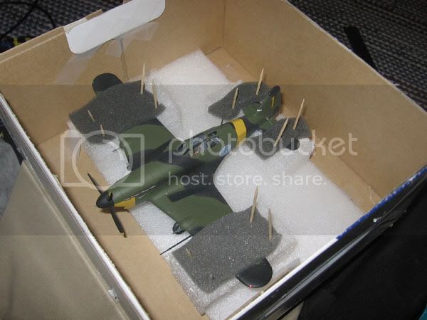

The last time I went to a modeling event, I came up with a solution that worked great with aircaft.
I first cut a piece of packing foam that fitted inside the box (styrofoam should work as well). Then I cut blocks of the same material, to which the model is attached. Position the blocks so that they will be under the wings and horizontal stabilizers. Finally, the model was fixed in place with toothpicks and strips cut from the packing material found in Games workshop blister packs. (of course, other materials can be used too)
If you attach the holders properly, you could transport the box upside down. (still, I wouldn't recommend that!
) Because the model is held only by the wings and stabilizers, antennas, pitot tubes, landing gear and other fragile parts won't be harmed while moved.
Here's one of my boxes with a Morane fitted in:
