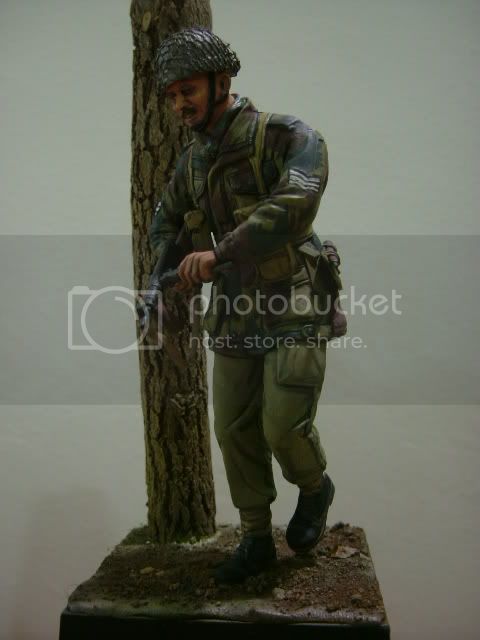

Figure painting is still one my weakest part of modelling. Mind briefly sharing the techniques you used to paint this figure?
I'm still learning myself as i go along, but do feel that I'm getting some kind of consistency.  The whole fig is hand brush painted.  A fine point brush is necessary especially to paint the face.  If you get the face rite, then the rest is no problem.  i use Tamiya flat flesh plus a bit of brown paint the skin. Then, I paint the eyeballs white and a dot of brown/ blue/ gey for the retina.  If the whites are a bit too big, it's O.K.  U can trim it off with skin color again.  Then I use diluted flesh plus more brown or orange to highlight the lines of the face like the eye socket area, along the nose, cheek bones, wrinkles.  Once it dried, I will use diluted flat black to highlight again those areas that are much deeper like the sides of the mouth and also the eyes.  Then probably u have to do some kind of shading with different tones of flesh to accentuate the cheekbones, chin , below the neck.  I'm not how much of help this is but glad to be of assistance.  The first few times, it's trial & error I guess.
