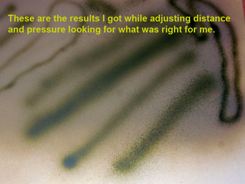

Here is where I had to overcome my first issue; having used Badger siphon fed airbrushes previously I had to get used to using much lower air pressures and train myself to make the most of this airbrush and its capabilities. This highlights one of the things everyone new to airbrushing has to overcome, and that is that an airbrush will not allow you to paint like Mig Jimenez from the get go as it is a skill set that will get better and easier the more you practice. I will say that I found this gravity fed airbrush easier to get along with a faster learning curve than I did a siphon fed Badger airbrush, I am a little unsure whether this is down to previously learnt skills or not.
I found the best pressure for me to work with was between 10  15psi as opposed to the 20  30psi I was accustomed to with the Badger airbrushes. I did find that at less than 10psi and over 20psi I struggled to prevent too much paint hitting the plastic which will cause runs if care is not taken, under 10psi I found I was having to get too close to the subject to clearly see what was happening. This brings up another skill set that needs to be learnt and that is how much closer to the subject you can work without hitting problems with paint application.
There is a possible weakness to this brush which is that broad coverage is not the best in its supplied configuration, but that may be improved by purchasing the 0.5mm set up available separately. It is also worth mentioning that due to the lower pressures that can be used and paint control it provides that your paint goes further saving you money in the long run.
