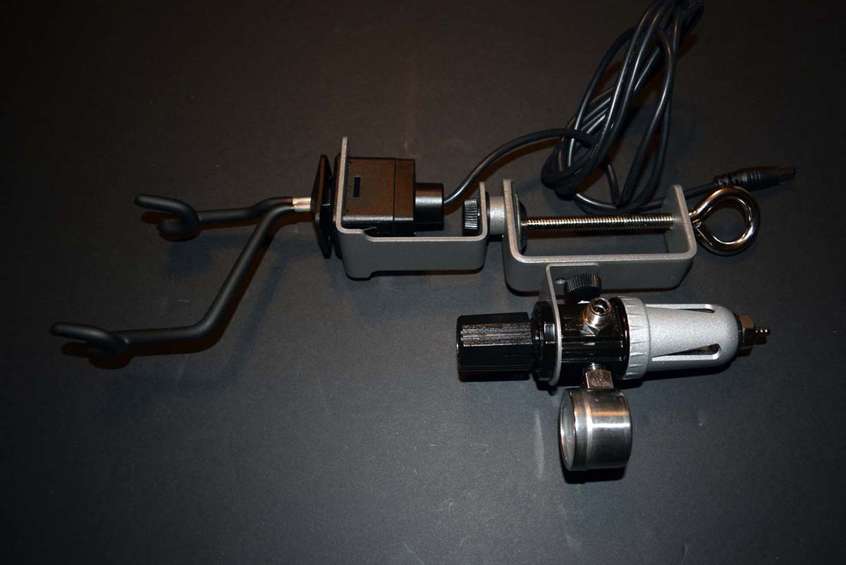

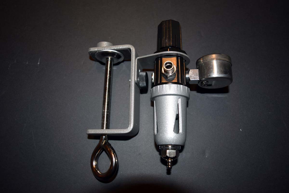

In the box you will find a surprising number of parts; the moisture trap is provided attached to the clamp for attaching it to a table or even the body of the compressor. The smart stop switch is also in the top box and this has a bolt that attaches it to the clamp and moisture trap. The last part of this area is the airbrush hanger that stops and starts the compressor; the frame is metal that has been covered with a rubber using a method that I am unfamiliar with. The wire for shutting down the compressor runs from the bottom of the smart stop switch and plugs straight into the compressor without any issues regarding fit. On the top of the moisture trap is a lift and turn knob for adjusting the air pressure to an airbrush can be adjusted as required the gauge attached goes up to 100 PSI but something is very wrong if it gets that high. The moisture container is protected by a screwed on metal cover with vision slots cut into it, a nice inclusion for protecting an area that could be easily broken if someone is careless.

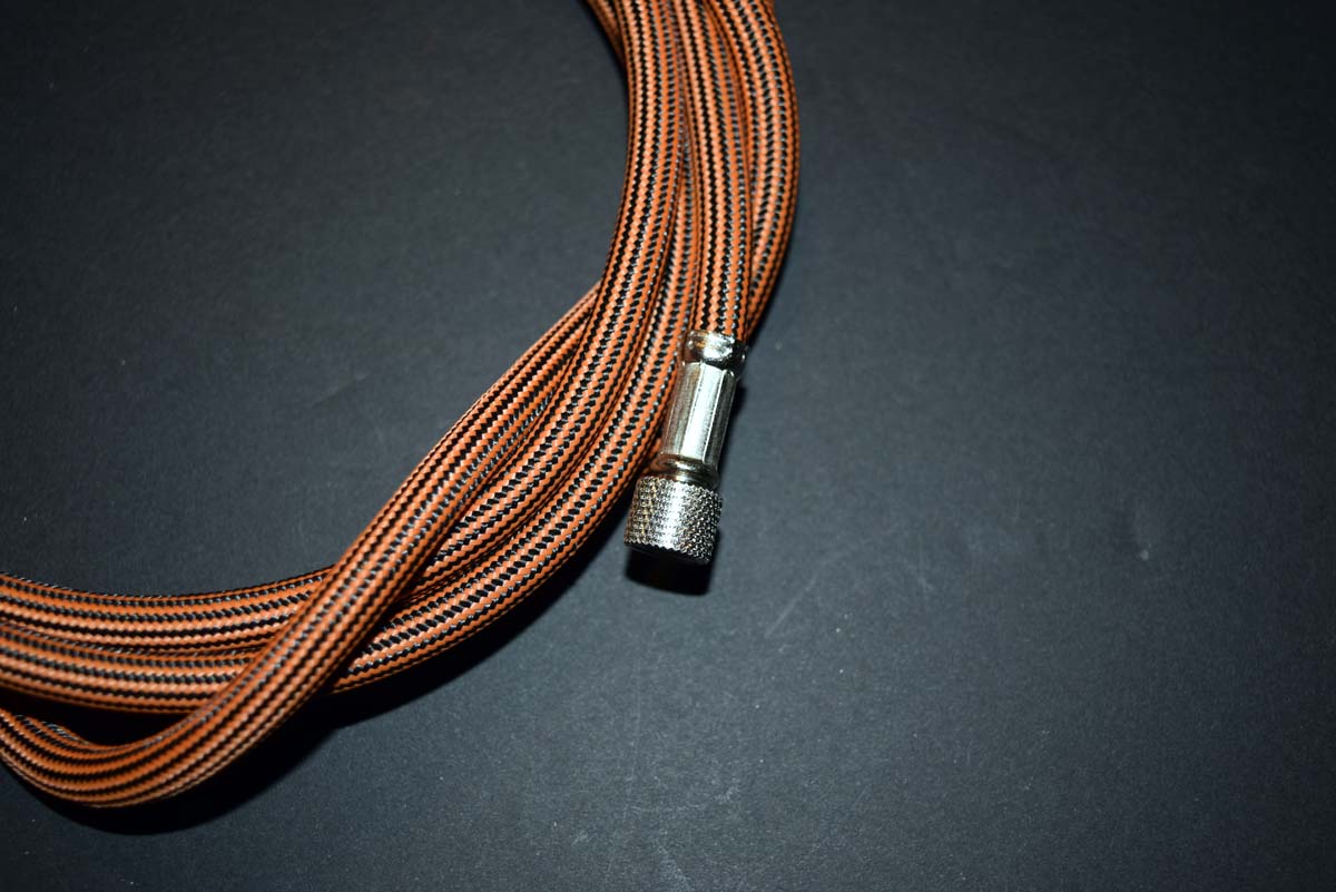

Connecting the compressor to the moisture trap is done using a coiled plastic hose that I am informed will stretch out to 4 metres in length; I am not a huge fan of this material as I have found that it dries out and becomes stiff with time. The other side is a 2 metre braided hose that I am very pleased with having used one on my own set up for some time with continued excellent service. The result of this is that your work station does not have to be near the compressor and so running noise becomes less important. When attaching the hoses to the moisture trap the air in direction is clearly marked on the trap itself.
