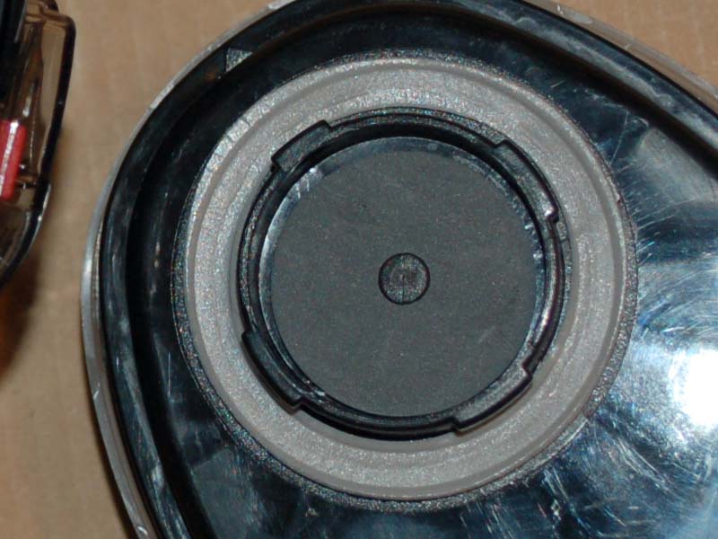

With the packaging of both parts being of a good standard there is also one other packing part that needs to be addressed. When you take the mask out of its packaging there is a stiff black plastic ridge around where the mask seals against your face, this fits to the mask so well that you may not realise it needs to be removed and if you don’t you will be thinking the mask is not very comfortable and the seal to your face will not be as it should.

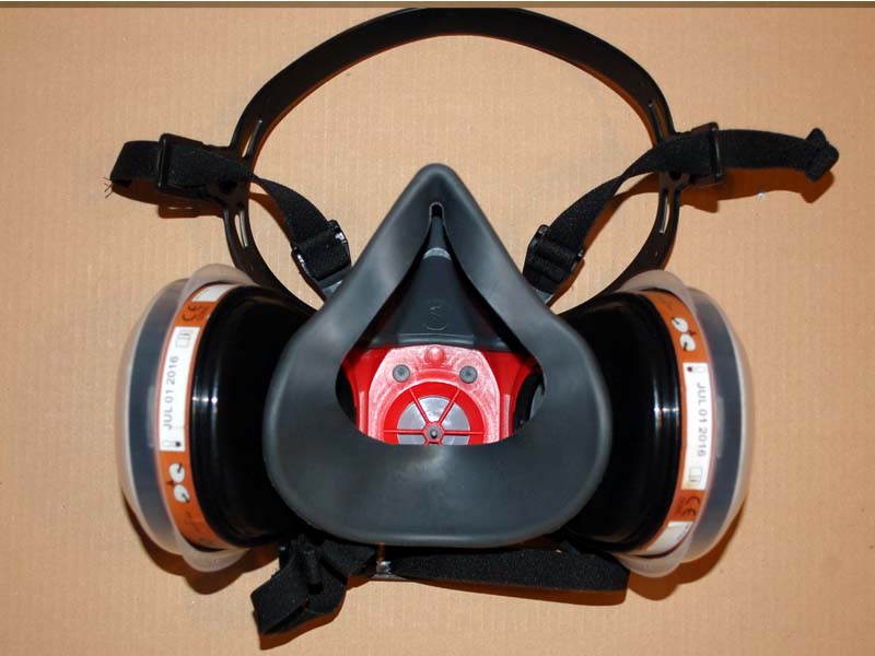

The filters when removed from the packaging have to be attached to the mask; this is achieved via four plastic ridges which twist fit into the body of the mask. The fit of the filters is very tight and requires firm but gentle pressure to seat them. Once attached the mating seal is very good. The mask protects against;

The body of the mask is listed as being a thermoplastic rubber, this is very much like the silicone moulds that have become popular in baking of late. The rubber is very flexible, comfortable to wear and seals very well against your skin. When this product arrived I had a few days growth of facial hair and the mask still provided a good seal against the skin, after a shave the seal was excellent. In order to test the seal I adjusted the straps for a good and comfortable fit and then covered the intakes of the filters with the palms of my hands, there was no air entering the mask and so the mask was doing what it should. Below is the bullet points supplied on this product;
- Superior low breathing resistance
- Fully-adjustable 4-point suspension harness with quick release buckles
- Durable thermoplastic rubber offering a superior fit to most face shapes comfortably
- Low profile angle of filters for minimum visual impairment
- Reflective strips create increased visibility in low-light environments
- Replaceable filter cartridges
- Conforms to EN140
It took me a while to figure out how to test the filtering element of the mask, and then a brain wave occurred. Wearing the mask I entered the bathroom, closed the door and let loose with spray can air fresher and deodorant; success! I could not detect any smell inside the mask, this indicates to me that the mask was doing its job to a good standard.
