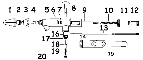

Ahoy Steve,
Check to see if the packing washer has not been displaced when the needle
was put back in....this is likely the problem.
See diagram ......... part no: 6........if no image........ go to link.
http://www.dixieart.com/Millschm.gif
Cheers,
Joe
Cheers,
Joe

Thanks guys for the advice. Gary, on this one, it's the tip that the needle slides through, it's not the aircap. It doesn't have threads, it just sits in this sort of a bowl. I wish it did have threads. Joe, I'm going to try that with the gasket. I thought about buying a new gasket when I bought the tips and the new spring, just because of something like this might happen. Like I said, the spray pattern is all wrong, it's ragged and I even have splatter far outside the the rest of the spray field and then there's the pulse. I'm reasonably sure it's not my thinning ratio, it's not the air pressure, it has to be the result of the tip change. Michael, I'm going try your suggestion as well and soak the body and parts in thinner.
