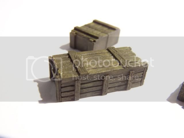

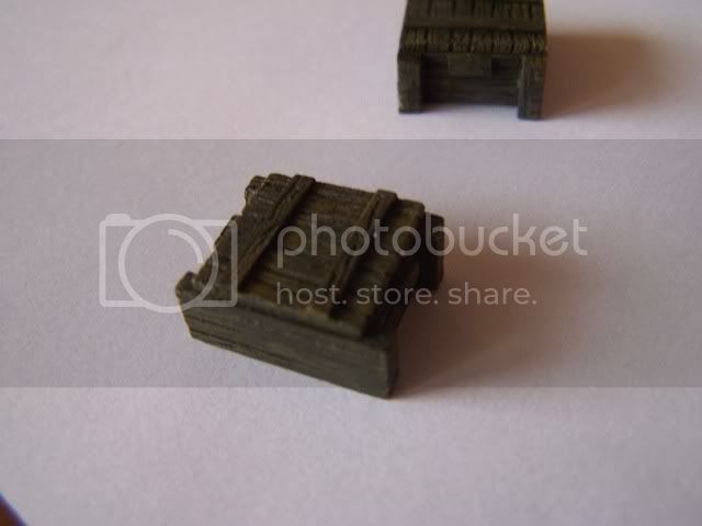

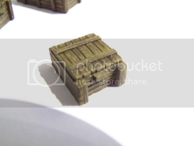

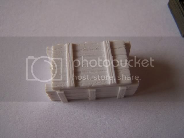

I recently bought some plastic sheets and experimented a little. As I need a lot of ammo and supply crates in my current D-Day Diorama project, I thought it might be a much cheaper solution to build them myself. I am pretty happy with the results plus it was a lot of fun to build them, not to mention that i learned a lot of new techniques building these crates myself. Anyhow the crates were airbrushed with Tamiya olive drab paint. Then I applied a "washing" with heavily thinned brown oil paint. The final touches were added with highlights done with olive drab and natural wood (valejjo) using a dry brush technique. The wood grain was done with an old cutter blade.
Here some pictures.
This is the crate prior to painting.
Here a finished one.
Here I took the crate that came with the Italerie kit 105mm howitzer, I cut the cross bars on top of the lid and the rods on the sides to size, and scratched the wood grain in the main box and the add ons.

Woah!!! Steve!!! I love your movies!! LOL Nice work they look like crates and that means they are good. How did you go about making your wood grain? I use a battery powered motor tool to do my wood grain. Also what do you use for joining pieces? If yo have not tried it already you should get a bottle solvent. I swear by it and only use super glues, epoxies, etc when I have to. Welcome to the forum!

They are very convincing and well constructed boxes/crates!
A good walk through on your technique also...
The finished product maybe still looks a little too gloss?

I used an old cutter blade to engrave the wood stucture. It works pretty well and is done very easily. To join pieces I used the regular plastic glue from Revell. I must say it works pretty good but I will definitely try the bottle solvent you recommended! Sounds like it is magic stuff.
@Honeycut:
You are right, the boxes still look very glossy that is because I haven't put any clear flat on it yet. Sill gotta do that!
