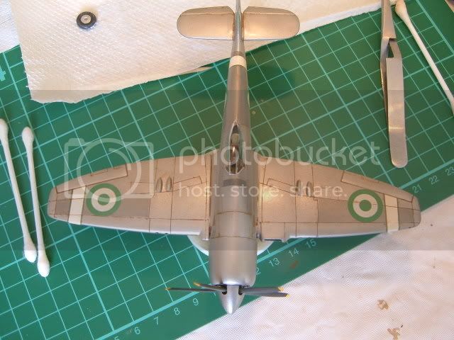

Posted: Saturday, July 29, 2006 - 08:31 PM UTC
I would go with metal, I think Hawker's actually used aluminium dope, so silver will be fine and should contrast, slightly, with your NMF. If they are already painted (NMF) Leave 'em and give 'em a wash
Mal
Cheers Mal. I'll do that. Havent started the undercarriage yet so no probs there.I'll be doing that tonight I hope.
Decals are on and its coming together nicely.
Nige

Looks really good mate, can't wait to see this finished.
Now thats one mean looking plane.

Looks wonderful, those markings do look good. What are you going to do about the canopy?

Cheers Mal.
The canopy is just resting on top at the moment and will be masked and Alcladed soon
