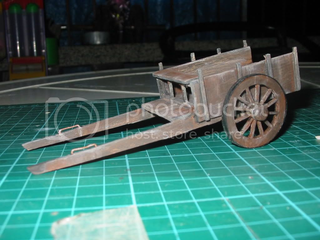

Pre,
Are you tring to build a cart wheel like the one below?
If, yes, then I could probably help you out...but the problem is that its not made from styrene...

Arvin,
Why don't you tell us how you did it ? I am very interested in your way to do such a cart wheel.
I am actually using a Wheel from a LEGO- Wildwest wagon do simulate an medieval light. (with candles on top of it).
Claude
