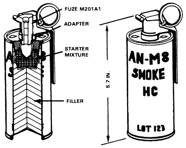

I have a solution to your problem. Instead of a M18 Smoke grenade, paint it as a AN-M8 HC Smoke Grenade.
The canister is light green in color, almost the same color as an iterior of a Bradley. The top is white and the lettering is black.
Or an Incendiary grenade, AN-M14 TH. Body is red in color with black markings. "The grenade is gray in color with purple markings and a single purple band (current grenades). Under the standard color-coding system, incendiary grenades are light red with black markings."
Or an AN-M83 White Smoke Grendae. "The grenade has a forest green body with light green markings, a blue band, and a white top."

Pete, I was considering this... However, I'd like to make M18s. I'm waiting for the quotations from decal making companies and will try some more "reverse printings"... if that doesn't work I'll take your suggestion.

They are supposed to be the M8 Smoke Grenades. I need to go back and remove the black band around them. I don't know why I put those there.
