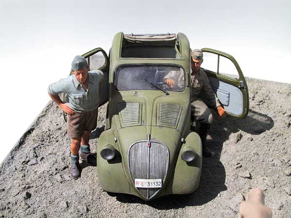

Model Victoria's FIAT 500 "Topolino" can be made into a civilian car. No changes are necessary to the model other than the license plates, which are provided.
Here's a picture of a civilian one:

Well, this very nice.
But thats just one car, and its best suited to WW2/early 50's.
otehr then that we dont have any options, oh the CMK VW is one but also more suited to WW2
