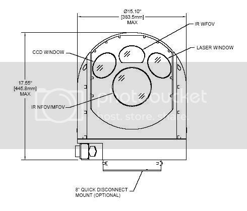

I am attempting to try my hand at scratchbuilding a new FLIR turret for a 1/35 scale USMC UH-1N. The current aftermarket version I have is not accurate.
I would be curious to hear from anyone regarding what type of materials would work best for this. Ideally, it would have to be something easy enough to sand and carve into shape, but tough enough to hold the fine details and recesses. Someone has already mentioned carvable resin foam, but I am unfamiliar with this material, and don't know what it would be sold as. I realize this project may also take quite a bit of artistic talent and fine motor skills I do not have, but I'd still like to give it a go, lol.
My quarry:
Scratchbuilding detail parts -- how to?

Thanks for the ideas guys. I think my best bet will be to try and find a craft bead of some sort for the sphere, then use your suggestions and fasion a styrene/putty turret around it. Here is more information for anyone interested in the measurements:
My calculations to 1/35th scale means I am looking for a bead or ball bearing 11mm in diameter (actually 10.96mm). The turret will be about 12.7mm tall. I'll post any progress if I can find the right materials, thanks again.
