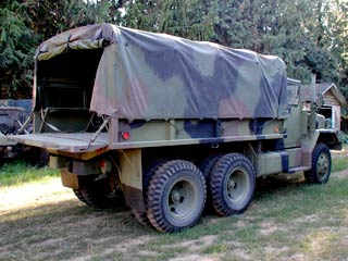

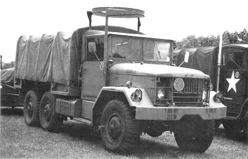

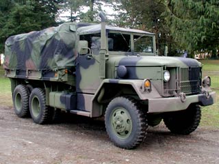

The main differences are in the bed. The M34 bed was lower, that is why the wheel wells were cut out. There is another frame rail that raises the M35 bed to clear the wheels. The M35 bed is straight, w/o the wheel well cut out.
You can see it in the pics below:
M34
M35A2 (With newer turn signal/marker lights, and exhaust stack coming up through right front fender. M35A1 had older style marker lights and muffler running along right frame rail and exiting between dual rear wheels.)
The cab is basically the same. You can see the height differance in the bed over fuel tank. The headlight setup was different too. High headlights ion M35, low on M34.
If you are looking to build an M35, the AFV Clib kit would be a better choice. It is highly detailed and builds up great. Much better than converting the old Revell kit.
M34
