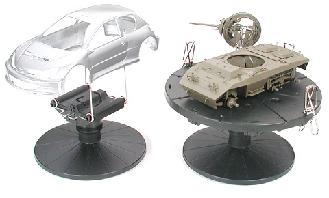

you might be able to get some ideas looking at the one tamiya made.
Frank
Tarok
Member Since: July 28, 2004
entire network: 10,889 Posts
KitMaker Network: 2,373 Posts
Posted: Wednesday, January 26, 2005 - 06:22 PM UTC
Here's the link to the Tamiya turntable
warthog

I got one like those...they are a big help. I also use gloves when painting to avoid paint in my hands as well as fingerprints on the kit..

That is a neat stand Tarok. Thanks for the link and I may just try one of those out.

I just love my Tamiya turntable!
It is really helpfull. I use it all the time. not only for painting, but also when I build the model.
Now I don't have to touch the model quite as often.
It's certainly worth the cost. And it's not that expensive either.
