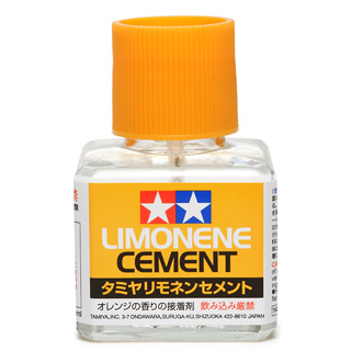

As for the original question, Tamiya sells also a Limonene glue that smells better but have heard it is not so strong as green cap one:
https://www.tamiya.com/english/products/87113limonene_cement/index.htm
Microscale's Micro Weld is like Tamiya's limonene. Smells like citrus, non-toxic but not as strong as solvent based glues.
