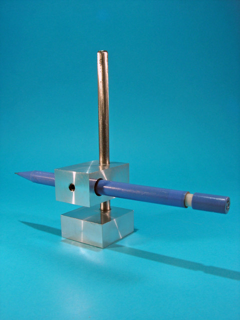

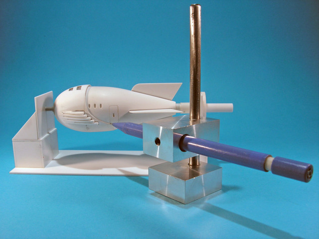

Posted: Tuesday, May 28, 2019 - 09:16 PM UTC
all,
Some very interesting and useful tools being produced here.
I hadn't really planned on joining this, however I had a need for a tool today so here I am
. I was in need of another height marking gauge so after a quick play on the lathe here's a very quick and nasty marking gauge. I was being lazy and didn't even swap to soft chuck jaws hence some jaw indents
and as you can tell I haven't even bevelled the edges (function over form, maybe tomorrow). Not pretty but does the job required of it:
and doing it's intended task:
Right now to see if I can get the photo's into the Campaign gallery

Nice idea on the DIY height gauge. Most are really too large to be of any use for modeling. May have to build/make a miniature one myself. Should be much easier than using the large one I have when dealing with 1/48 scale stuff.

Nice work on the 'Mark 2' Paul. Good to see that use gave you ideas for the improvements.
Simple but effective Roger. One of my club guys has something similar but he has a second hole for a scriber blade to be inserted in it. His bottom block has two parallel holes drilled through them for two rods to go through. These rods are secured at each end inside two blocks with matching holes. These blocks are attached to two corners of a large flat plate. This means his version of the base of your tool has guides to travel along.
He also has a rig to hold his model parts in, which he clamps to the flat plate to hold the kit part firm while he marks out in pencil and then scribes.
He uses it to scribe panel lines in the aircraft models he builds. It makes sure that all wing surfaces and both sides of the fuselage are identically placed.

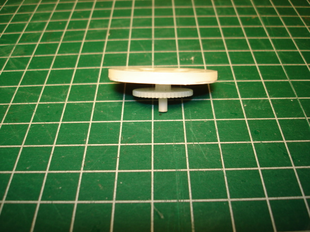

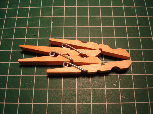

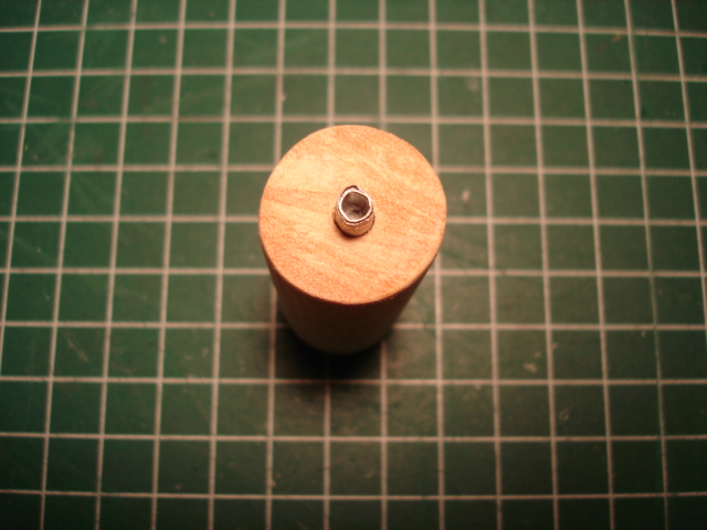

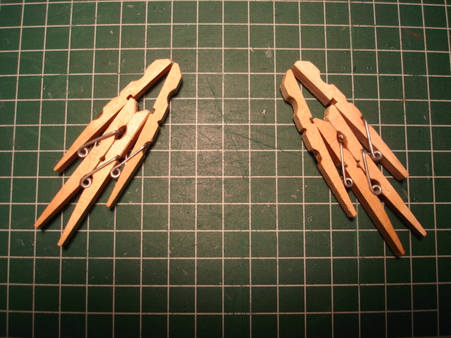

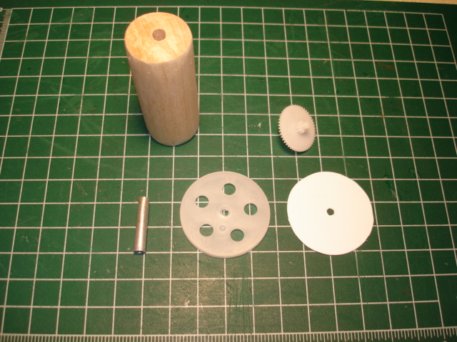

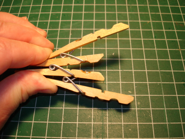

Posted: Thursday, June 13, 2019 - 04:42 AM UTC
If any white man tries to destroy what is mine, or take what is mine, or take my lands, I will take my gun, get on my horse, and go punish him. — Chief Low Dog - Oglala Sioux Chief

Posted: Thursday, June 13, 2019 - 08:14 AM UTC

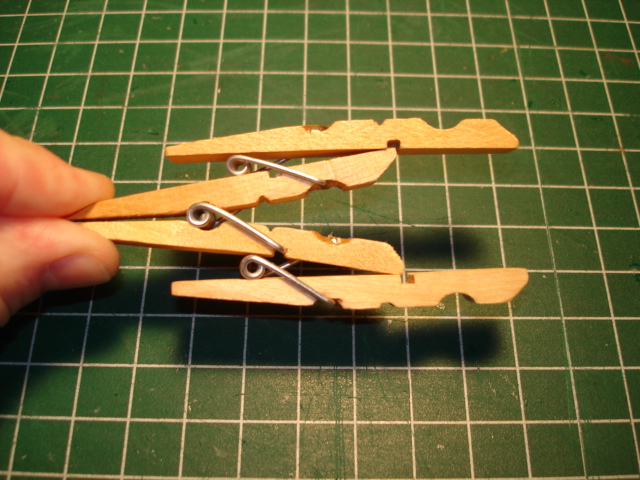

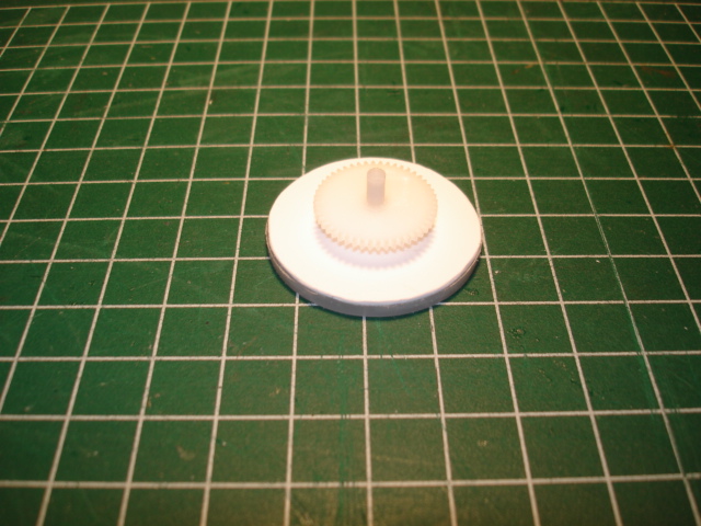

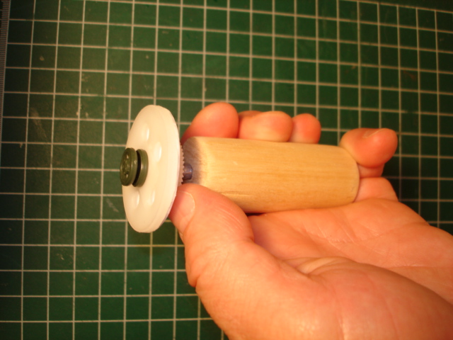

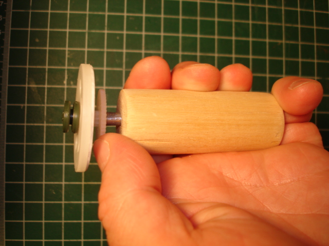

Nice ideas Randy. We are not looking for fancy here, utilitarian all the way!

Posted: Thursday, June 13, 2019 - 11:43 AM UTC
Thank you Peter, I appreciate it.
I'm not sure why the last two pictures are sideways, that isn't how they were uploaded.
