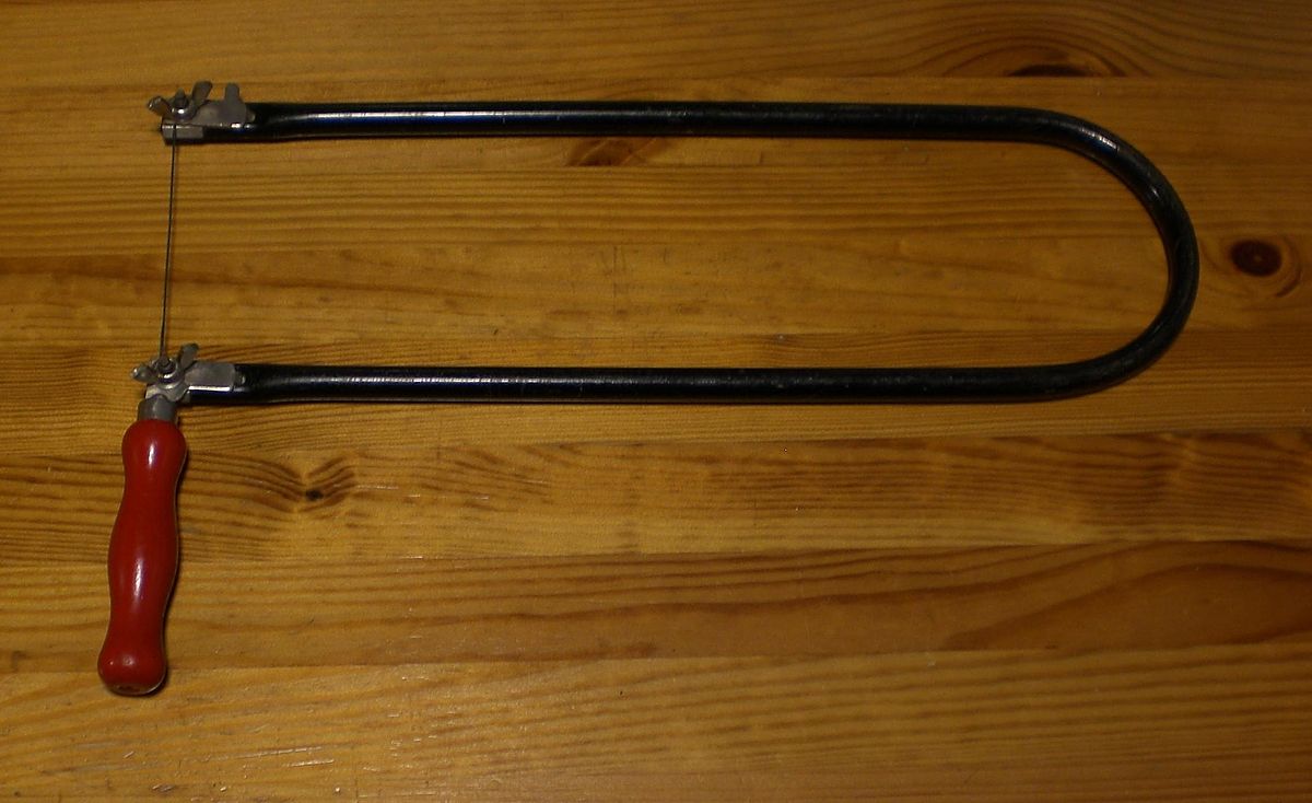

Posted: Thursday, August 24, 2017 - 01:05 AM UTC
This is what I use when I need to cut something in very tight spots where none of the tools/saws listed above will ge in close enough.
https://en.wikipedia.org/wiki/Fretsaw
This is another useful tool:
https://en.wikipedia.org/wiki/Piercing_saw
I just need a hole about 1 mm in diameter (1/25th of an inch or 0.04 inch) to get the blade through and start sawing.
The blades come with different size teeth, both for metal and soft materials like wood and plastic.
It is also great for cutting out large chunks of plastic when opening molded on hatches et.c.
/ Robin

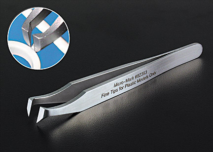

Posted: Friday, August 25, 2017 - 12:30 AM UTC
Hello..
I bought one of these from mirco-mark several years ago.. its the best thing I have ever found to get even the most delicate items off the sprue's..
Desprueing Tweezers..
hope the image shows.. LOL.
Delbert
Delbert
