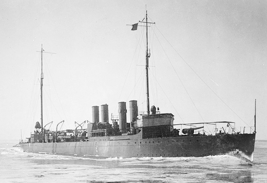

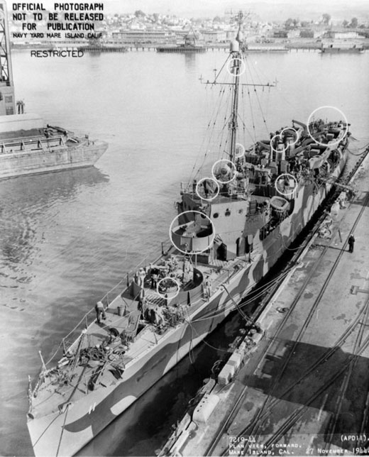

russamotto
entire network: 3,389 Posts
KitMaker Network: 625 Posts
Posted: Sunday, May 24, 2015 - 05:49 PM UTC

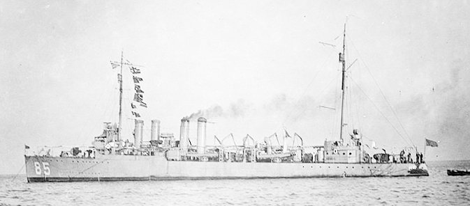

Wickes class destroyer Colhoun converted to high speed transport.
http://www.ibiblio.org/hyperwar/USN/ships/img/DD/DD-85_Colhoun.gif
http://www.ibiblio.org/hyperwar/USN/ships/img/APD/APD-2_Colhoun.gif
Forward stacks removed.

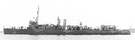

Gilmer, a Clemson class conversion.
http://www.ibiblio.org/hyperwar/USN/ships/img/APD/APD-11_Gilmer.jpg

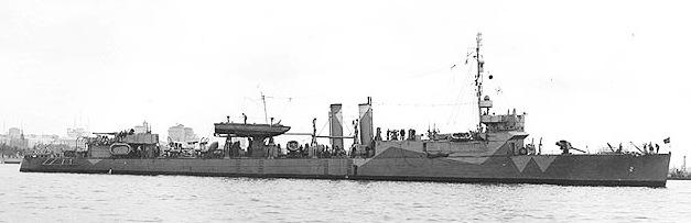

Gregory, another Wickes class.
http://www.ibiblio.org/hyperwar/USN/ships/img/APD/APD-3_Gregory.gif

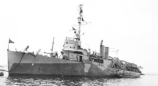

Little, Wickes class
http://www.ibiblio.org/hyperwar/USN/ships/img/DD/DD-79_Little.gif
http://www.ibiblio.org/hyperwar/USN/ships/img/APD/APD-4_Little.gif

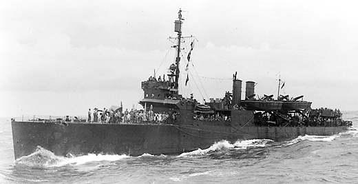

McKean, Wickes class.
http://www.ibiblio.org/hyperwar/USN/ships/img/APD/APD-5_McKean.gif

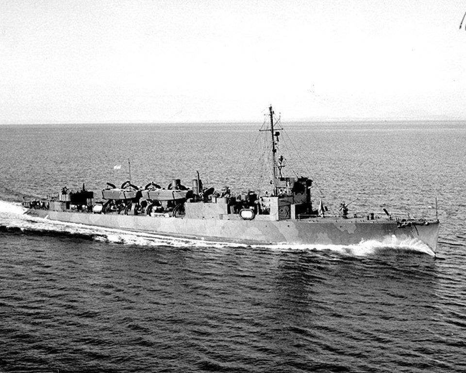

Dent, Wickes class
http://www.navsource.org/archives/10/04/100400903.jpg
Hope these help.
