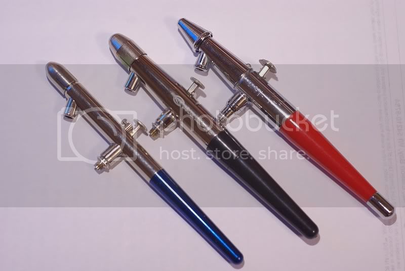

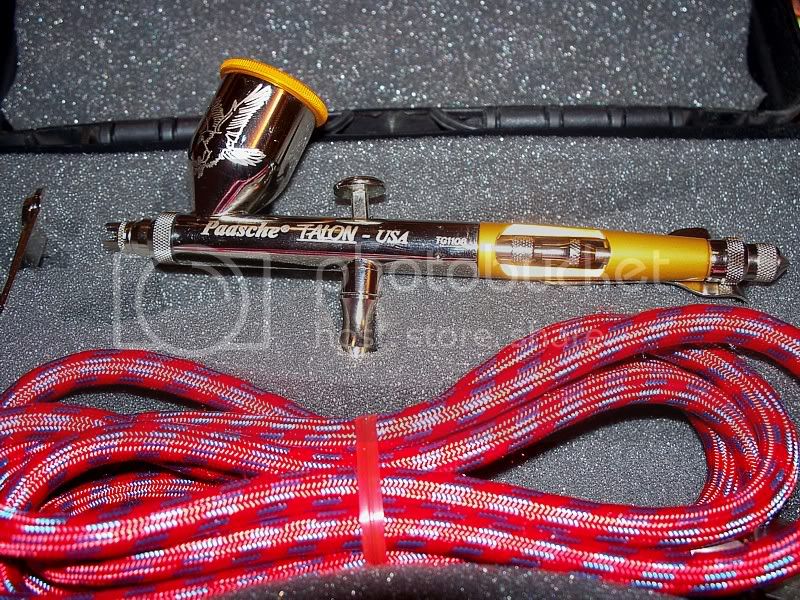

Actually a Paasche Talon is fairly cheap and a decent brush to start with. I started with a Paasche VL which I still have and use after 25 years. If your just painting models and your not worried about super fine lines, the VL will do the job. But there are many choices so do some research.
I have owned the 3 brushes below for no less than 20 years each and they all work great and are still used today.
Badger 150, Badger 175, Paasche VL
I also own the Talon which I recently purchased about 5 months ago.

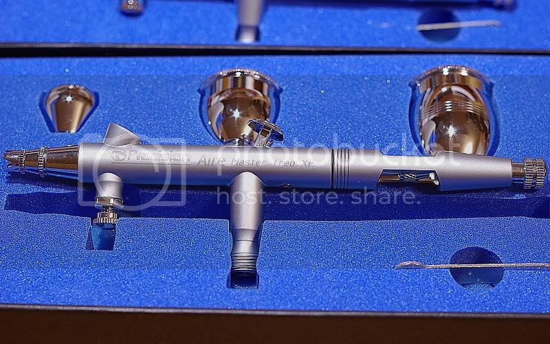

I havent had a chance to shoot with this one yet. It's a Pecision Aire Treo XF. I bought it for finer detail but havent had a need for it yet.
