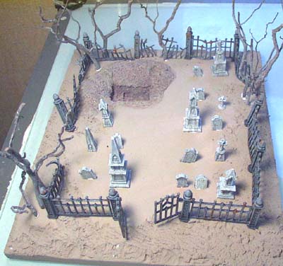

Check out your local "dollhouse miniatures" store... I found several generic White Metal headshtones for about $1.00 each.... I used them in the graveyard section of my Abbey Ruin feature article shown below ("Last Rites: Coloring a Church Ruin").
And Sabot... if the original poster doesn't take your offer for the kit you mentioned, let me know - I'll take em! [email protected]
