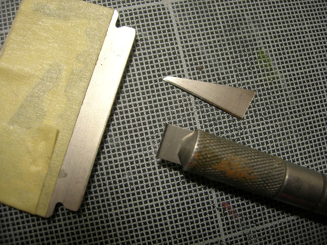

Get an X acto chisel blade. You can cut them as narrow as you want to fit in tight places. I have cut a few this way. Gently scrape away detail at a 90 degree angle, NOT shallow, or you will dig into the plastic. It's a little rough, but if you plan on replacing the texture you'll never see it.

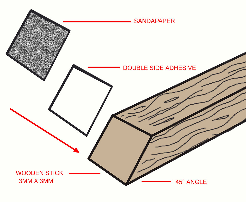

Usually, when I have very little room for my sanding tools, I made my sanding stick.
Using double-sided tape I attach a wooden stick stir (Those that Mc Donald uses are perfect...and free) on the back of a sand paper sheet. After then I cut all around the wood. This way I obtain a very narrow sanding stick. If I need a sanding tool more narrow a can shape the "head" of my tool because the wooden styr sticks are quite sturdy

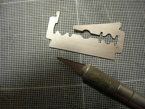

Otherwise if I need blade smaller than the x acto one, I usually shape a razor blade with a pair of scissor
I hope this will be useful for you

Thanks for the replies. Scraping with a blade was the only possibility i got in mind because cutting is not an option. The tip with the razor blade is great!

Ingenious tool Bernd,congrats indeed!
I think i'll do something similar when I have to sand in avery little room
But instead of using sprues I think I'll use wooden stick and two side adhesive to fix sandpaper (that will allow me to change the consumed sandpaper)
It'll look more or less this way:
Thanks a lot for inspiration
cheers
cheers
