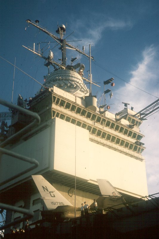

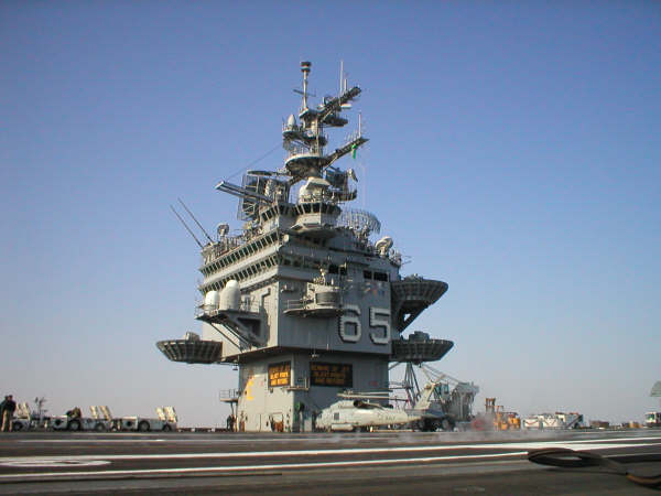

Another challenge to be overcome is the modern "dome" radar system, as well as a few other features of the current era.
I may be off-base here, but are you referring to the phased-array radar dome (often referred to as the "beehive")? If so, this was a feature of Enterprise as originally built. When refitted in 1979, this was removed and replaced with a conventional radar array
Before 1979
http://www.navsource.org/archives/02/026519.jpg
2004
http://www.navsource.org/archives/02/026556.jpg
The Tamiya kit represents Enterprise about 1981-82 and has the conventional radar array.

Not off base at all. I welcome help like this, as I know some of the terms I use are not accurate. I refer to the white half spherical domes(which some have referred to as "mushrooms") that seem to  have been installed post 2000 from what I can tell. Articles I have read on the recent re-fits seem to rely on the reader being familiar with military systems & terminology, which I am still learning. My modelling has revolved around rail until now, and I'm finding the learning curve to be steep! Research is important & any pointing in the right direction would be greatly appreciated.
