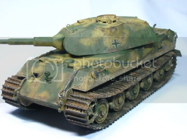

Softedge iyong parang blurred and hardedge iyong kabaligtaran or sinsabi mong sharp. The best way to do it is free hand in my opinion see sample below....

sana makatulong kahit papaano kasi bumisita lang ako sa site....matagal na ko di gawa model he he he

hi there..best way to start and paint camouflage is..map the pattern by using pencil..when you're done..paint the base color first..sa akin dark yellow or sandy. then yung pattern colors...using airbrush..hinaan mo lang PSI(pressure) para ma-control mo yung edges.. pag tapos kana..and you like to fade more the edges..apply pastel colors..same way to weather the surface. you can now make adjustments on the colors and edges....check this out...
hope this will help.
