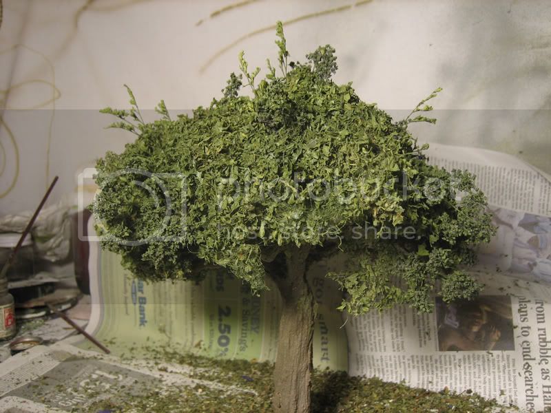

It isn't the best photo but you can see that the smaller branches are completely covered.

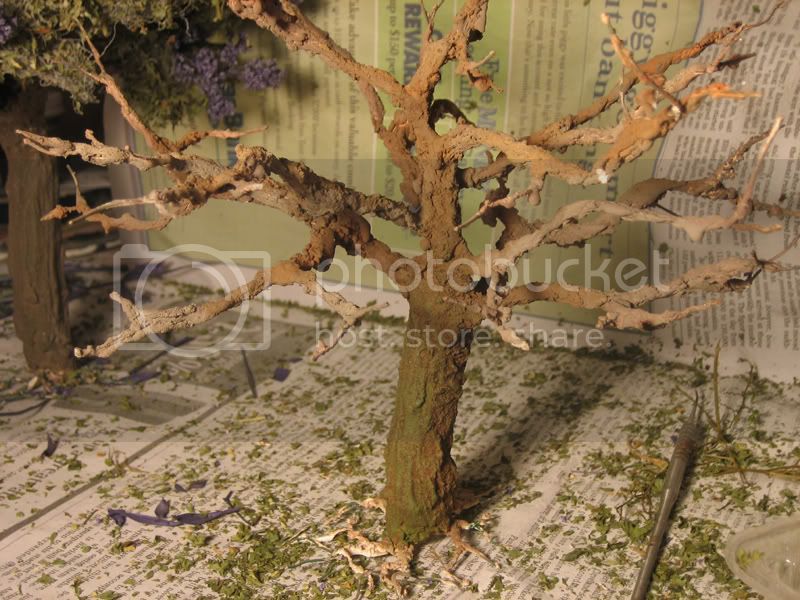

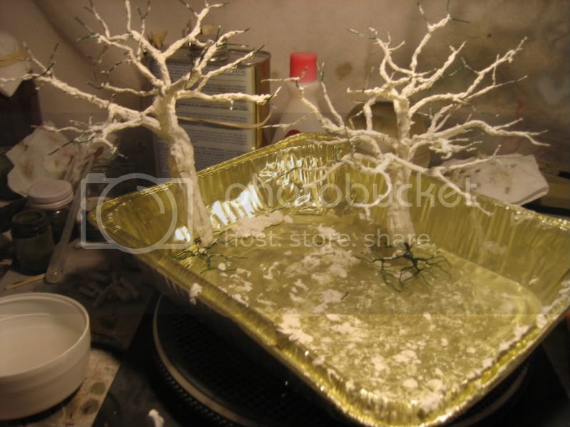

Thanks for the response Brian, the trees were too large to justify the use of magic sculpt so I just used some joint compound and it worked great. I can't believe I didn't use this stuff before. I never thought about letting it sit for awhile before forming it, that really made the difference.
There are some cracks and wobbly spots, but I like you said, the leaves will cover most of it. Maybe I'll add a thin coat of the sandy tile grout for a bark texture. For a first real tree, I think it's coming along alright.

Looking good. See a bit of patience and experimentation can work wonders. I haven't tried joint compound before - do you think it would take some pigment or acrylic paint? If so then you could add a dark brown/gray into the mix so you don't get white spots showing where you miss with the paint (or it gets chipped).

Just saw this one - joint compound is the trick. I use it too, I use it for A LOT of applications.

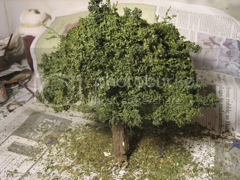

Bob, after the plaster I added bathroom tile grout, mixed with water and white glue, to the tree and it seemed to do a good impression of bark. Adding the glue helped with the strength, for sure. I didn't see your vignette, can't find it after searching, but sounds like a good idea. And next time I'm gonna die the plaster a brownish color, like Brian suggested, as you can see some of the bark chipped when I was handling it. Nothing a short touch up can't fix though.
Painted them brown, with some various filters and this is the result:
Are the random limbs poking out too showey? I wanted a wild untamed look about them. An M18 is gonna sit in between them, with foliage camouflage.

what did you use for your foliage?
zemzero
Ohio, United States
Member Since: May 28, 2005
entire network: 177 Posts
KitMaker Network: 38 Posts
Posted: Tuesday, January 26, 2010 - 06:58 PM UTC
The main bulk if it was parsley flakes over steel wool, with other spices and some outside crap found on the ground thrown in for good measure. I also added bits of dried flowers I bought from the art store "Micheals". The purple stuff is Candytuft and the thin stuff poking out is Caspia, they were about $3 for a bunch. I plan on using those for the foliage camo on the tank.
I airbrushed different shades of green all over everything, then added a little more parsley to it.

Eric - great looking tree. I especially like the bark effect with the "mossy" green touch.
Parsley looks pretty good too - I seem to recall using parsley, oregano and some other dried spice that had a "leafy" look to it, just to give it some variety is size and shape within the foliage mass. Made it all smell pretty good for a while .

The moss look is terific. Too often overlooked. Nice touch.
