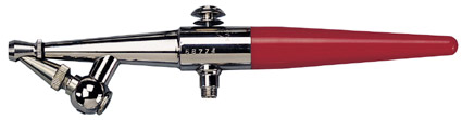

Single-action means that one control button will mix the air and paint when depressed. It’s like a switch, either on or off. Paint flow has to regulated manually by turning a collar. Fine lines are still possible with these, but the adjustments can be frustrating.
PASCHE H-SIPHON FEED SINGLE ACTION-EXTERNAL MIX
